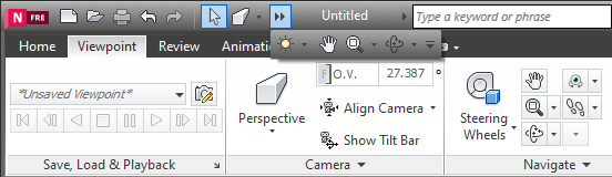

At the top of the Navisworks window, the Quick Access toolbar displays frequently used commands.
| Navisworks | Navisworks Freedom |
The Quick Access toolbar can be positioned above or below the ribbon. You can add an unlimited number of buttons to the Quick Access toolbar to the right of the default commands, and add separators between the buttons. Commands that extend past the maximum length of the toolbar are displayed in a flyout button
Click the Customize Quick Access Toolbar drop-down button
Choose either Show Below the Ribbon or Show Above the Ribbon.
