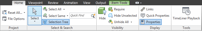

The ribbon is a palette that displays task-based tools and controls.
| Navisworks |
| Navisworks Freedom |
The ribbon is divided into tabs, with each tab supporting a specific activity. Within each tab, tools are grouped together into a task-based series of panels.
Some of the tabs are contextual. When you execute some commands, a special contextual ribbon tab is displayed instead of a toolbar or dialog box. For example, as soon as you start selecting items in the Scene View, the previously hidden Item Tools tab appears. When nothing is selected, it becomes hidden again.
