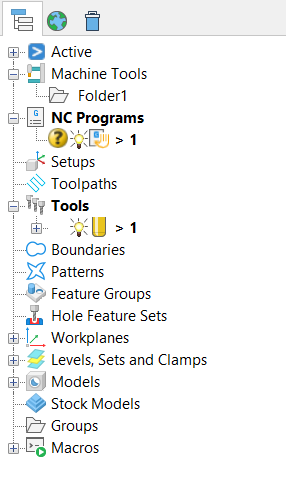

Checking which entities are active
Before you create the finishing toolpaths, you can ensure they are automatically added to an NC program:
  1. Check if the NC program in the Explorer is shown in bold and preceded by the > symbol to indicate it's active. If it's not active, right-click the NC program name, and select the Activate option.
  2. Expand the Toolpaths node and click the light bulb icon (until it shows ). This undraws each of the roughing toolpaths. Now you can easily see the new finishing toolpaths as you create them.
