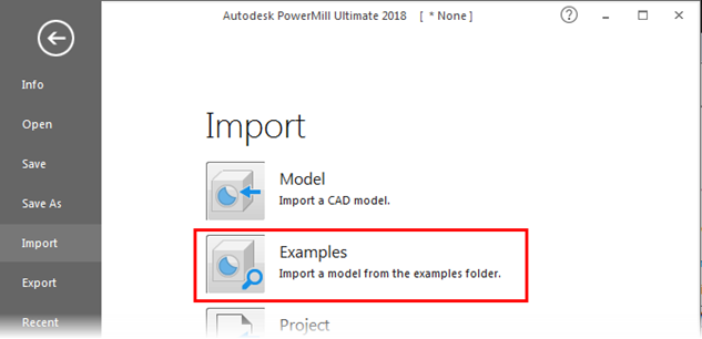

  1. Click File tab to display the Backstage View and select Import > Examples.
    The Open Examples dialog is displayed, automatically opening the drive and folder where the tutorial files are installed:

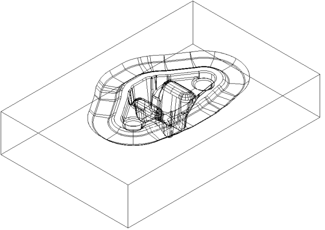

  4. Click View tab > Navigate panel > Resize to Fit to fit the model within the display.
  5. To change the display to an isometric view, click View tab > Views panel > ISO, and select an option from the menu. The model looks like this:
