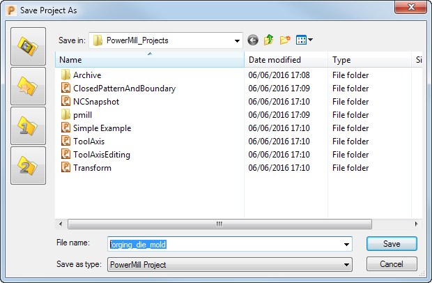

  1. Click File tab > Save. Because you have not previously saved the project, the Save Project As dialog is displayed.
  2. Open the directory that you created for your projects, and enter a name for your project in the File name box, for example forging_die_mold.
  3. Click Save.

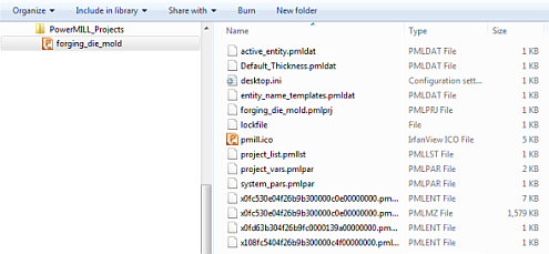

    The PowerMill window header displays the name of the project.
    An associated file structure is created:
Warning: Do not manually edit these files because you will corrupt your data.
