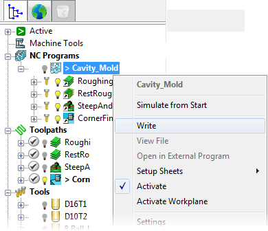

  1. In the Explorer, right-click the NC program, Cavity_Mold, and select Write from the context menu.
    The tool symbol next to a toolpath indicates a tool change. It is always displayed for the first tool in the sequence. It is also displayed when a different tool is used.

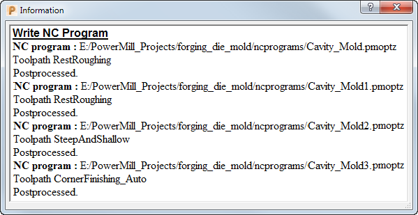

  2. PowerMill postprocesses the toolpaths using the specified parameters, and displays a confirmation window showing where the files are saved.
  3. Click to close the Information window.
