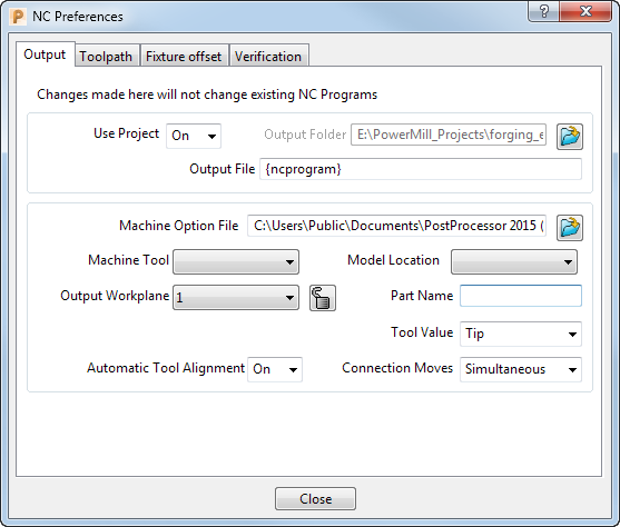

This displays the NC Preferences dialog.
Select Use Project - Off to write the NC program file to a different folder. You need to specify it in the Output Folder box.
The variable %[ncprogram] gives the output file the same name as the NC program. You can add your file name to this variable.
next to the
Machine Option File box.
to browse to the folder where the option files are stored. Several machine option files are available in
C:\Users\Public\Documents\Autodesk\Manufacturing Post Processor Utility\Generic.
