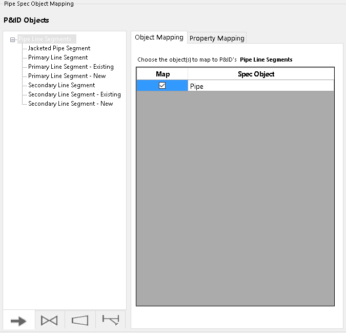

Pipe Spec Object Mapping dialog box
Object Mapping
Specifies the mapping for a P&ID object to a matching pipe spec object.
Map
Select whether to map this object or not.
Spec Object
Select the spec object to map to.

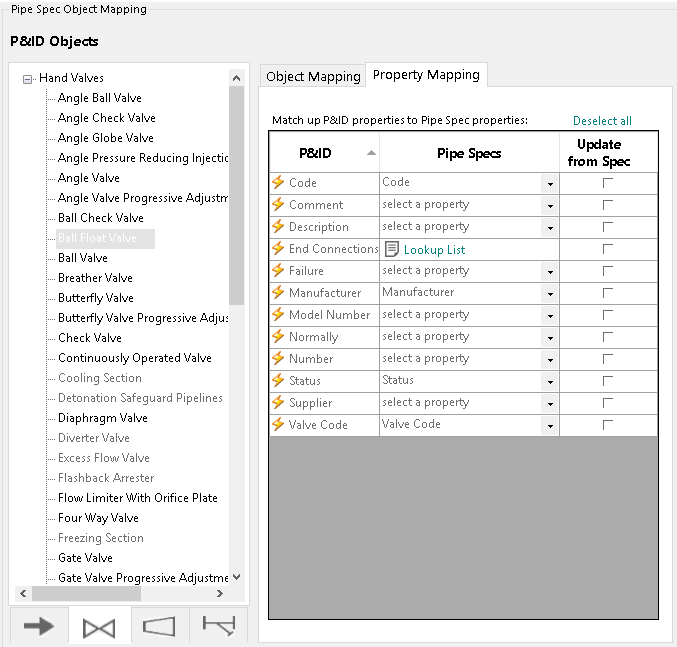

Property Mapping
Maps P&ID class properties to Pipe Spec Object properties
P&ID
Lists the P&ID property name.
Pipe Specs
Lists the Pipe Spec properties available to map to the selected class.
Update from Spec
Designates whether the P&ID property will be updated by the value of the specified Pipe Spec property.
