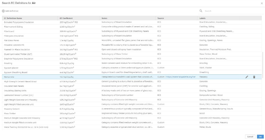

- In the construction summary, expand the Embodied Carbon definition value to display the search window.
- Click Advanced Search.
- From the top of the Advanced Search Window, click Add Definition.

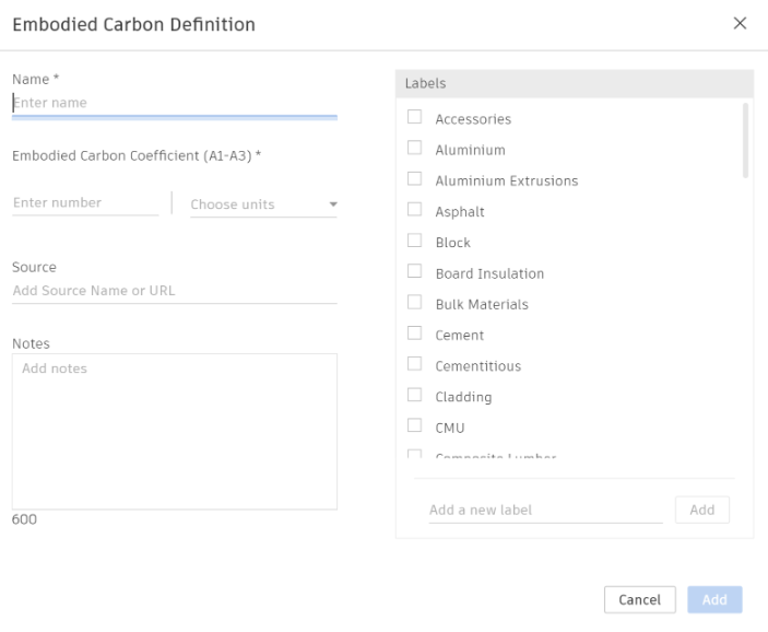

- Inspect the results and the embodied carbon definition, assign an embodied carbon coefficient, and assign labels to the definition.
- Click Add.
