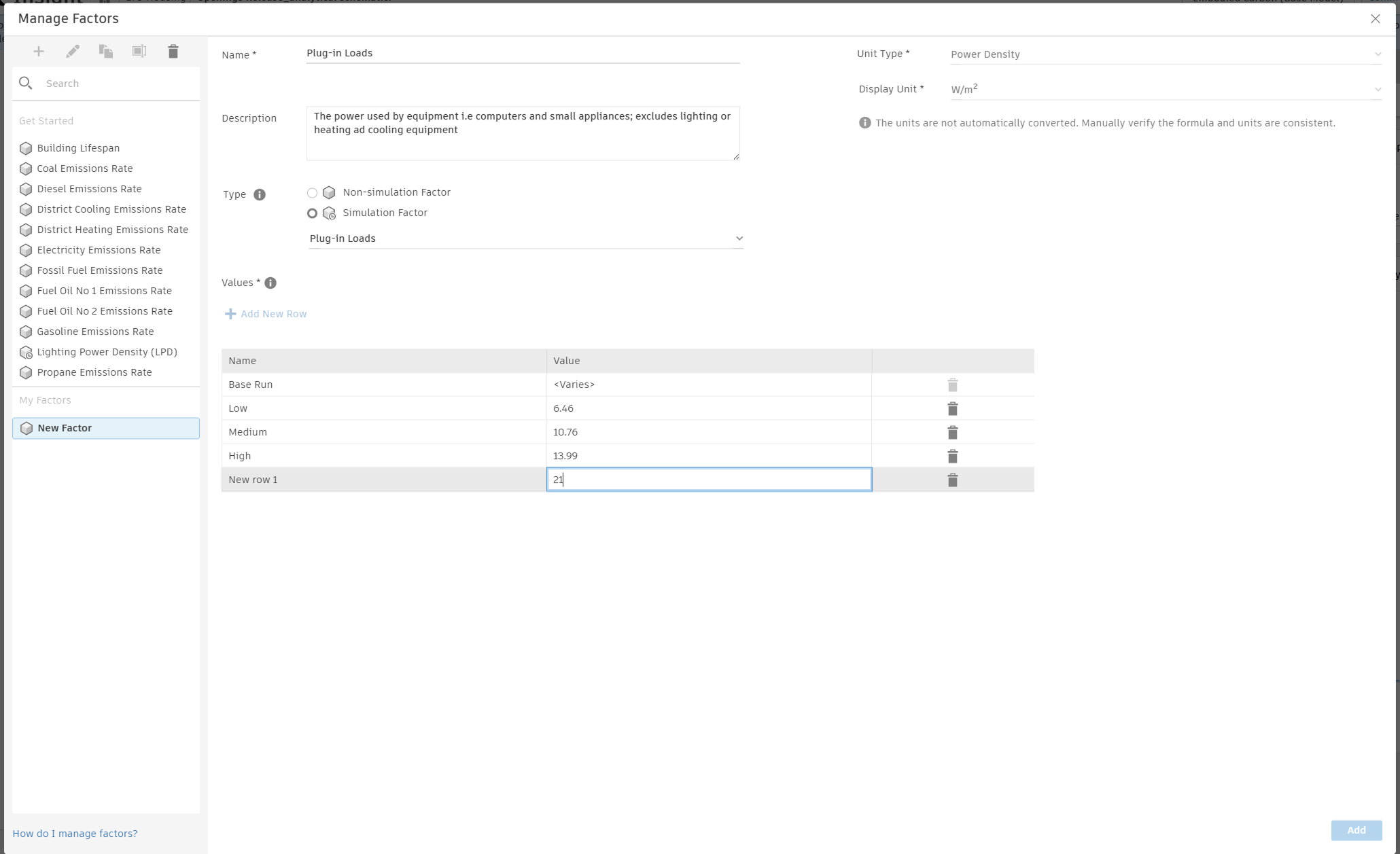

Factors provide values that are used in metrics during an analysis of your model. Autodesk Insight Total Carbon offers a list of default factors for your convenience, but you also have the option of creating custom factors for more detailed analysis. These default factors include emission rates for various fuel types and a factor for the study period, which relates to a building's lifespan.
The list of available factors is displayed on the left side of the dialog. Use the controls at the top to copy, rename, and delete factors.
 icon.
 icon.Name
Unit Type
Description
Display Unit
Type
Non-simulated factor - The results fo the factor are immediatly reported in the dashboard.
Simulated factor - An additional simulation must be performed on the model in order for results to display on the dashboard. For additional information see Simulation Factors.
In the Values section of the dialog, edit or add values as needed.
Click 'Add' to create the Factor.
