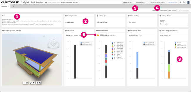

View your energy analysis results in the overview dashboard of Insight.
The dashboard contains a summary of the energy analysis run on your model. Basic model information such as location, building type, and area is included a well as embodied and operational carbon totals are displayed. The overview organizes the information into a number of areas on the dashboard:
About this Insight - The box lists the assumptions made when creating the energy model and performing the embodied carbon analysis.
General Information Tiles - Contains general information about the model and specific analysis data.
Performance Metrics - Contains results related to the energy and operational carbon analysis. i.e., Energy Use Intensity, Operational Energy, and Operational Carbon.
Embodied Carbon Details - Open the embodied carbon details of the model. Visualize the embodied carbon in the model viewer and graphs to gain a detailed understanding of the embodied carbon analysis. Use the construction summary area to assign and edit embodied carbon details related to constructions used in your model.
Manage Factors/Metrics - Open dialog to Add, Edit, and Delete, Factors and Metrics used in the analysis of the model.
Embodied Carbon Warning - A warning is displayed when embodied carbon definitions are missing. For additional information see Create and Edit Embodied Carbon Definitions.
