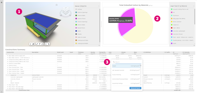

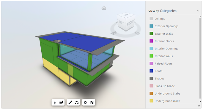

The 3D model viewer lets you view the analytical model representation of data in your model that has been assessed in terms of energy and operational carbon metrics. You can use the dropdown option to view the data from different perspectives:

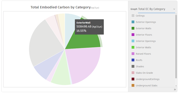

The embodied carbon graph can be used to view embodied carbon results by materials and construction, or by embodied carbon intensity by area. The total embodied carbon is measured in kgCO2e. You can use the dropdown to view the data from different perspectives:

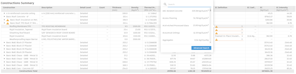

The construction summary lists the constructions and their material layers, including descriptions, attributes, quantities, embodied carbon assignments and embodied carbon results. View constituent materials by expanding the construction name in the summary. Constructions shown in the table marked with a
symbol indicate that there is not an embodied carbon definition associated with the construction.
To assign an embodied carbon definition to the construction, click the EC Definitions value to expand the search window. This allows you to quickly search for and assign existing embodied carbon definitions to material layers. You can use the Advanced Search button to perform an extended search, add or modify definitions. For additional information, see Create and Edit Embodied Carbon Definitions.
