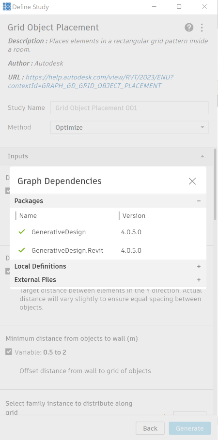

To access the Graph Dependencies dialog
Go to the Study Options menu in the Create Study dialog and select View Graph Dependencies.
Using the Graph Dependencies dialog
The graph's dependencies will be listed in the Graph Dependencies dialog, sorted under headers:
- Packages: Collections of custom nodes that extend Dynamo's functionality.
- Local Definitions: Dynamo-specific files corresponding to local custom nodes and local packages.
- External Files: External documents in the graph space, such as images or text files.
In addition to a name and version, each dependency is accompanied by an icon:
- A checkmark means that the dependency is installed.
- An X means that the dependency is missing and needs to be installed.
- A warning means that there is a version mismatch in the installed dependency. The graph may still run, but if there are issues, try installing the correct dependency version in Dynamo.
