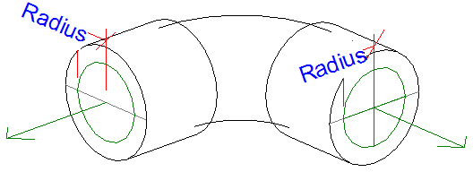

An elbow pipe fitting family with an angle controlled by a reference line
