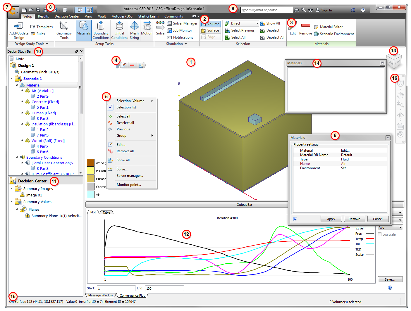

This is the default layout of the Autodesk® CFD User Interface:
ui overview
1. Graphics Window: View the model
The background color in the Autodesk® CFD Graphics window is set by the background color in the CAD tool.
To override this, open the Application menu, click Options, and change the setting for Background color to User defined.

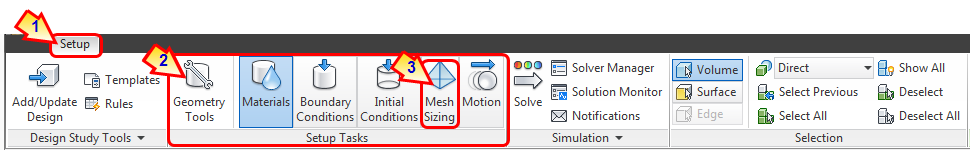

  1. Tab: The top-level organization level of the ribbon. All commands in a tab share a common purpose, and either support a particular stage in the simulation process (Setup and Results) or help accomplish a specific objective (View and Get Started).
  2. Panel: Groups of closely related commands
  3. Command: Individual commands on the ribbon. Commands come in several forms including buttons and menus.
Throughout the Autodesk® CFD Help topics, procedures refer to specific commands from the ribbon. To ensure clarity, each reference consists of the tab name, followed by the panel name, followed by the command name (Tab > Panel > Command).
For example, this is the reference to the Solver Manager command in the Simulation panel of the Setup tab:

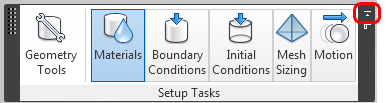

In the title bar of some panels, a small arrow indicates that additional controls are on a panel drop-down menu. To view these controls, click the arrow on the title bar of the panel:
expand ribbon
By default, the menu disappears after the mouse if moved away. To lock the drop-down menu, click the pin icon:
pin expansion
To hide the drop-down menu, click the pin icon again.

To hide a panel:

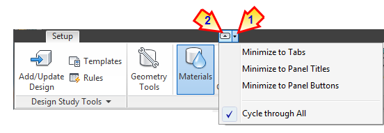

To minimize the ribbon:
There are three ribbon minimization modes: tabls, panel titles, and panle buttons.
minimize ribbon
Note: To use the arrow button to step through each mode, select Cycle through All.

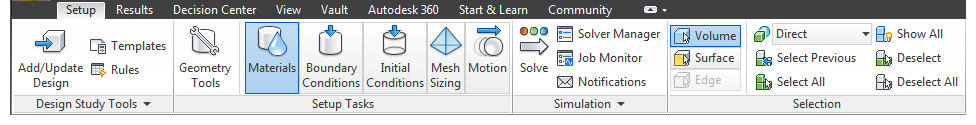

Setup
Use the Setup tab to define and run the simulation model:
ribbon setup
Note: The Setup Tasks and Simulation panels contain the primary controls for setting up and running a simulation.

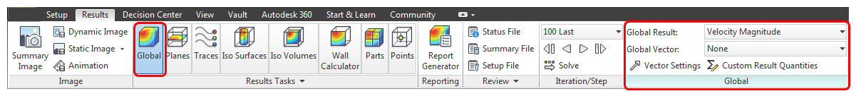

Results
Use the Results tab to visualize and extract results data:
ribbon results
Note: The Results Tasks panel contains the primary tools for extracting and interpreting simulation results.

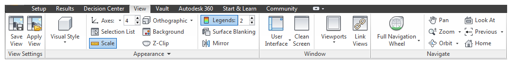

View
Use the View tab to control model appearance and to customize the User Interface:
ribbon view

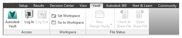

Vault
Use Vault to store and manage Autodesk® CFD data in the Autodesk Vault.

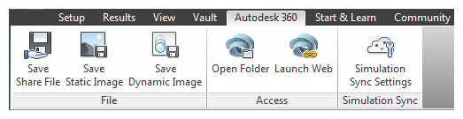

Autodesk 360
Use Autodesk 360 to sync Autodesk® CFD results images and setup files to your Autodesk 360 Documents folder.
a360 tab

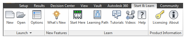

Start & Learn
Use the Start & Learn tab to create or open a design study and to explore Help Resources:
start and learn

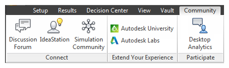

Community
Use the Community tab to Interact with other Autodesk® CFD users
community tab

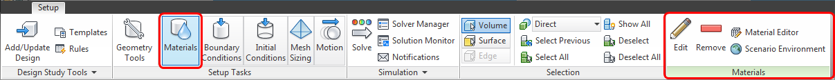

3. Context Panels
The controls in (Setup > Setup Tasks) and (Results > Results Tasks) invoke specific task modes that are the fundamental steps in the Autodesk® CFD process. Several commonly-used controls related to the active task are placed in an additional context-sensitive panel on the right side of the ribbon.
For example, when the Materials task is active on the Setup tab, the Materials context panel appears:
materials context
When the Global task is active on the Results tab, the Global context panel appears:
global context

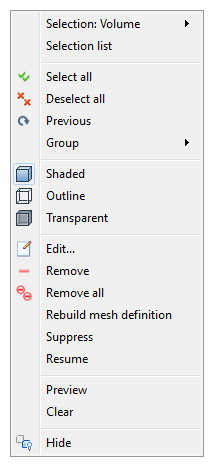

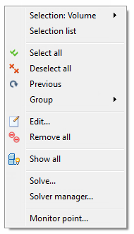

5. Right-Click Menus

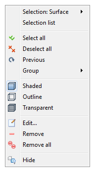

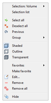

The right-click menus contain commonly used controls that are contextual to the current task. They provide convenient access to commands while allowing focus to be maintained directly on the model.
Setup Tasks
On every Setup task, use the right-click menus to change the selection type, select and deselect items, and open the appropriate Quick edit dialog. Additionally, access commands specific to the current task.
Right click off model:
right click off model
Right click on part (Materials task):
right click part materials
Right click on part (Boundary Conditions task):
right click part bc
Right click on part (Mesh task):
right click part mesh

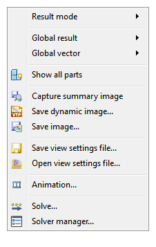

Results Tasks

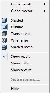

On every Results task, use the right-click menus to modify the appearance of the model, part, or results object.
Right click off Model:
result right click model
Right click on Part:
result right click part

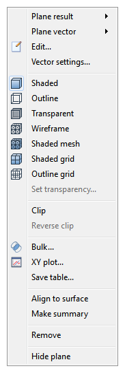

Right click on Plane or Iso Surface (while either Planes or Iso Surfaces task is active):
result right click plane

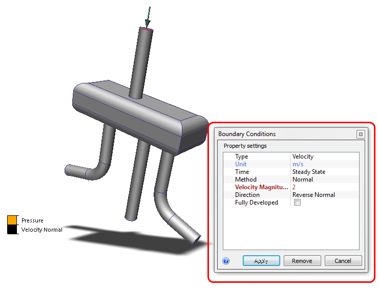

6. Quick Edit Dialogs
The quick edit dialog is the primary tool for specifying parameters and values for model set up and result extraction. Every task has a unique quick edit dialog that contains fields for task-specific settings. They are an essential workflow element of Autodesk® CFD.
quick edit pre
quick edit traces
They are several ways to open quick edit dialogs:

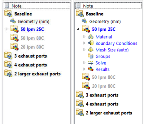

10. Design Study Bar: Manage all aspects of the Design Study with the Design Study bar
design study bar
The Design Study Bar is a fully interactive tree-based tool for defining and managing all aspects of the Autodesk® CFD process. The Design Study Bar follows a hierarchical structure that organizes the Autodesk® CFD process into three fundamental levels: Design Study, Design, and Scenario.
Each design study contains at least one design (specific CAD geometry) and each design contains at least one Scenario (collection of materials, boundary conditions, and mesh settings, along with the associated analysis results). Designs are listed in bold black letters and scenarios are shown in bold blue letters. The setup assignments and results are listed in thin blue letters within each scenario. Manage the analyses from this window.
Optionally, click here to learn more about each branch of the Design Study Bar...

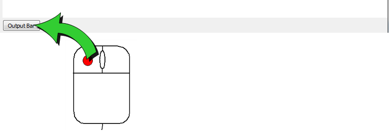

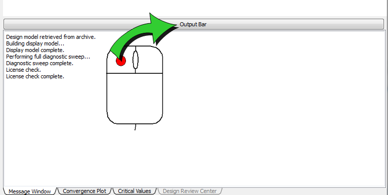

12. Output Bar: View analysis status information and important results data
Collapse the Output Bar as needed:
collapse bar
To expand the Output bar:
expand bar
13. View Cube
The Autodesk® ViewCube® is a highly interactive, persistent tool for controlling the orientation of your mode. It provides a simple way to select standard (Cartesian-aligned) and isometric views of your model. The ViewCube tool provides visual feedback about the current viewpoint of the model as view changes occur.
You can use the ViewCube to quickly orient in any of 26 pre-set orientations, rotate the model about the Cartesian axes, and reset the model to its default orientation.
viewcube
By default, the ViewCube appears in one of the corners of the graphics window in an inactive state. When the cursor is positioned over the ViewCube tool, it becomes active.
To orient the model, switch to one of the available preset views, roll the current view, or select the Home view of the model.
You can also customize the appearance and behavior of the ViewCube to your preferences.
14. Selection List
The Selection List displays items that have been selected in the Setup tasks. This is especially helpful for knowing exactly which items are selected.
In the Planes and Iso Surfaces Results tasks, the Selection List displays the list of existing planes or iso surfaces, respectively. In the Wall Calculator, Parts, and Points Results tasks, use the Selection List to interact with the controls of the current task.
To control the display of the Selection List, click the toggle in the Quick Access toolbar:
selection list
15. Status Bar: View Results values
Values are shown in the Status Bar, located in the lower left corner:
status bar
16. Navigation Bar
The navigation toolbar is a collection of several tools for controlling model orientation and the view. It floats over and along one side of the graphics window. To activate a navigation action, click a button on the bar. Some of the buttons have additional tools in a sub-menu. To access these, click the small arrow below the button.

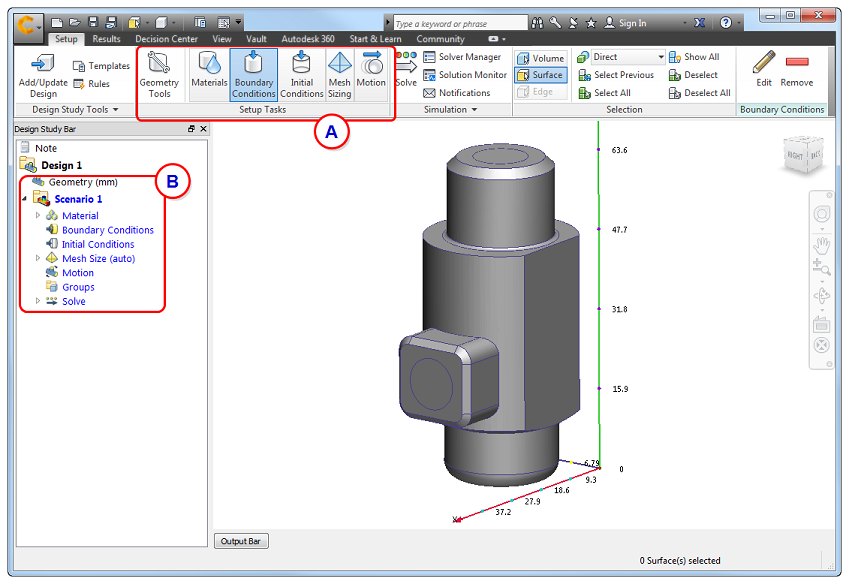

The Setup tasks all follow a similar workflow. There are several ways to work with the model. You should use the method that is most comfortable.
To begin, select the task from either the Setup tab (A) or from the Design Study bar (B):
task selection

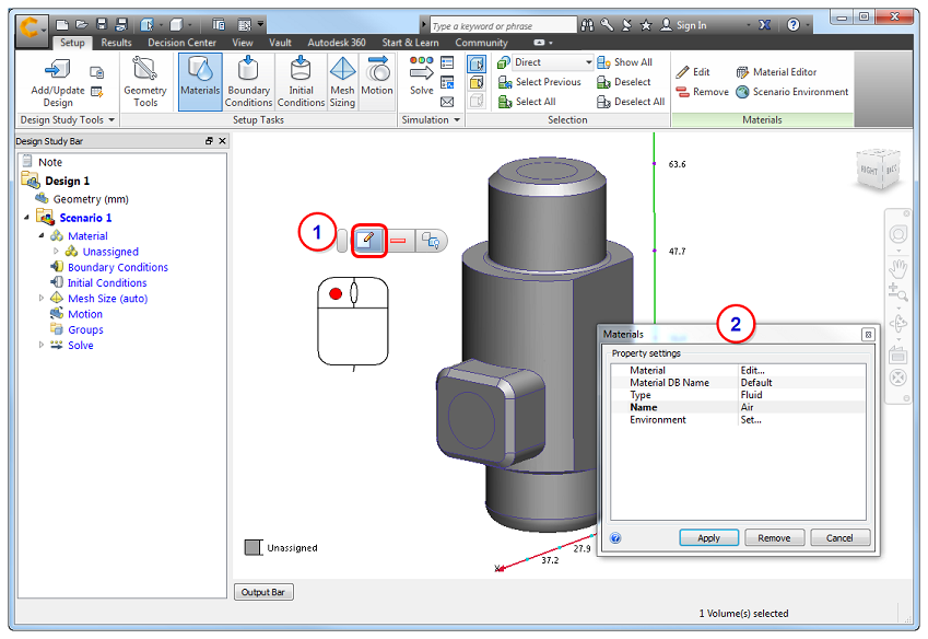

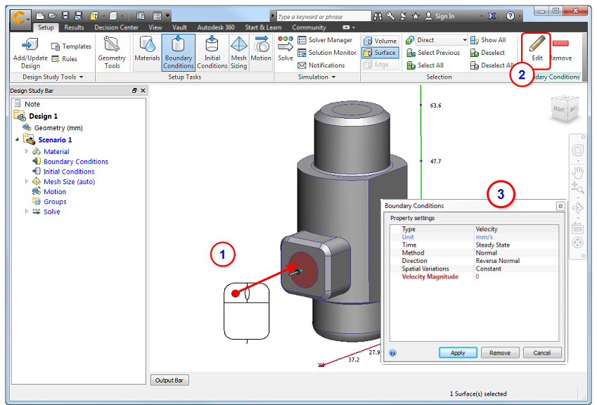

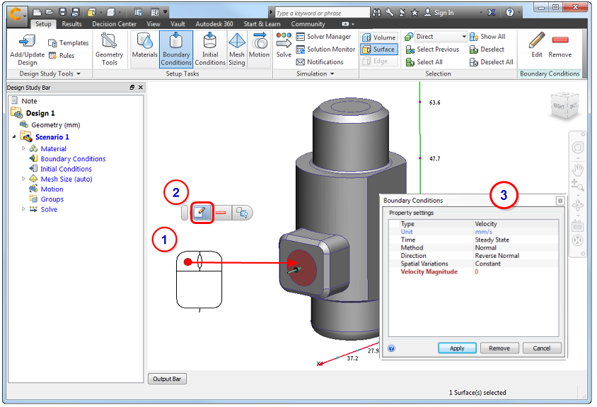

To select and define settings with the Ribbon:
  1. Left click on the model entity (surface or part).
  2. Click Edit on the context panel.
  3. Specify settings in the quick edit dialog.
pre ribbon
To select and define close to the model:
  2. Click the Edit button on the context toolbar.
pre ribbon airlook

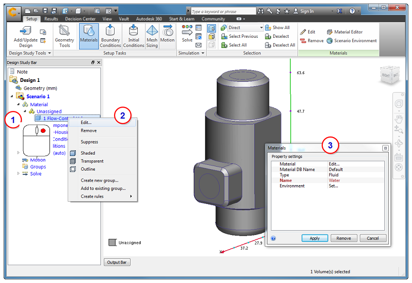

To select and modify from the Design Study bar:
  1. Right click on the model entity or existing setting in the Design Study bar.
  2. Click Edit...
pre ribbon study bar

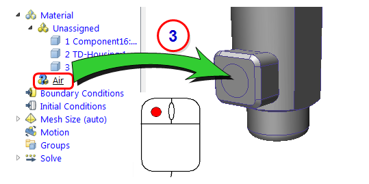

To define and assign:
  1. Open the quick edit dialog. (Left click and select Edit on the context toolbar.) Alternatively, right click on Material or Boundary Condition in the Design Study bar, and click New material... or New BC..., respectively.
  2. Specify the settings in the quick edit dialog, and click Apply.
  3. Drag the unassigned setting from the Design Study bar onto the model entity.
assign airlook
drag unassigned
Note: To apply a setting that is currently assigned to another entity, drag it from the Design Study bar onto the target entity.
