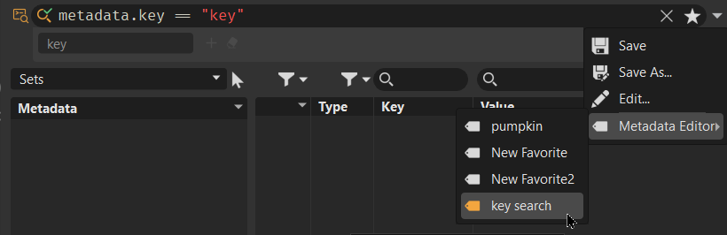

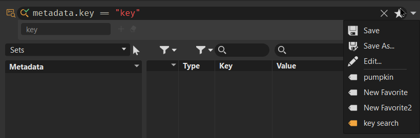

Menu Structure - Select the default behavior of the Favorites menu structure. Choose from Grouped and Flat.
Write/File - Sets the default file used for writing the current saved favorites to. Click Add File to add a different .json file to the list. Click the icon in the Write column to set the file to use. To remove a file from the list, click the icon next to the file to select it, then click Remove File.
