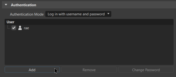

  5. In the Authentication section, change Authentication Mode to Log in with username and password.
  6. Click the Add button, then add a username and password.
  7. Click Apply and Save. The new user will appear in the User section.
