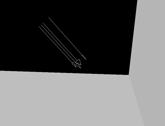

Directional Light
Light rays from directional light sources are parallel like sunlight. A directional light represents a distant light source and has no position, only a direction that affects how the scene is illuminated.
Directional Light

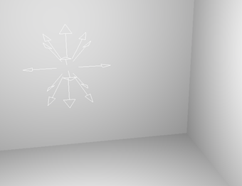

Point Light
Point light rays start at a single point and emit radially.
Point Light

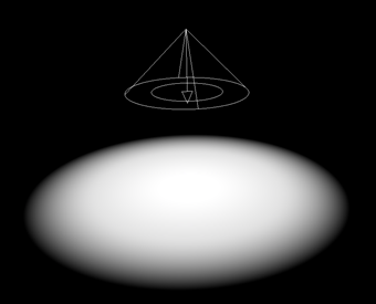

Spot Light
Spot light rays follow a beam cone. They start at a single point and spot in a circular area on the object. It is often used to emphasize an object or surface.
Spot Light

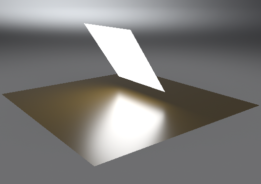

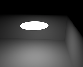

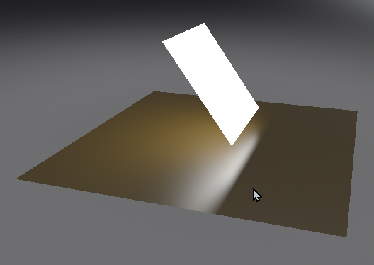

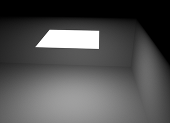

Disk Light or Rectangular Light
The disk and rectangular lights are area lights that emit light from a flat surface, either from a circle (disk) or square (rectangular).
Disk Light Rectangular Light

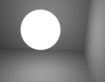

Spherical Light
The spherical light is an area light that emits light from a sphere. It is more realistic than point light.
Spherical Light
