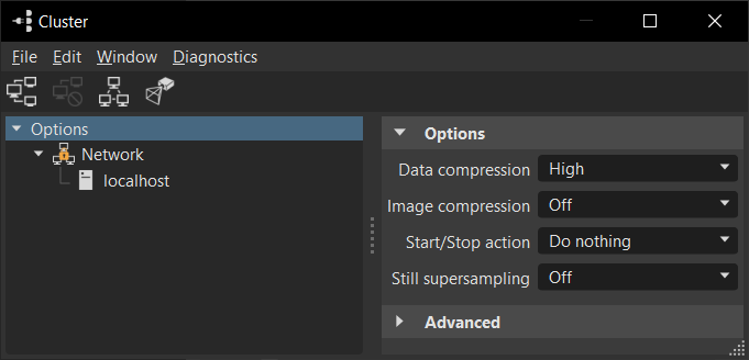

Cluster Options
Click the Options entry in the tree to access these cluster options:
  • Data Compression - Compression method used to transfer the Scenegraph from VRED to the cluster nodes.
    • Off - No compression.
    • Medium - Fast but low compression ratio.
    • High - Slow but higher compression ratio.
  • Image Compression - Compression method used to transfer the rendered images from the cluster nodes to VRED.
    • Low (lossless) - Low compression without loss of quality.
    • Medium (lossy) - Fixed compression ratio of 1/3 and fast.
    • High (lossy) - Slow but high compression ratio.
  • Start/Stop Action - This option can be used to prevent excessive rendering times on cluster stop or cluster crash.
    • Do nothing - No action is performed on cluster start or cluster stop.
    • Downscale Off/On - Switch downscale Off on cluster start and back to On when the cluster stops.
    • Raytracing On/Off - Enable raytracing during cluster rendering and use OpenSG rendering when the cluster stops.
    • Rendering On/Off - Rendering is switched off, when the cluster is not running.
  • Still Supersampling - If the CPU use during still antialiasing is poor, then by increasing the image size the use could go up. With a supersampling of 2x2, 4 pixels are rendered by the cluster and later combined to a single pixel. To get the same rendering quality, the number of image samples should be reduced by a factor of 4. (9 with 3x3, 16 with 4x4)
