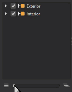

List View
The List View displays all annotations, which can be grouped and toggled on to display or off to hide by checking or unchecking the box next to an annotation or group.
Right-click an annotation to access the context menu containing options for creating, grouping, repositioning, duplicating, selecting nodes, deleting, and toggling annotation display, editing a description, zooming to an annotation, as well as loading and saving annotations.
To expand or collapse the hierarchy of the tree in the List View, use the slider or its buttons.

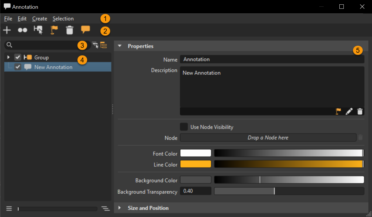

Attributes
Use these sections to customize annotation text, font and background color, as well as size and position.
Contains options for adjusting the font, line, and background color, and background transparency, as well as these:
Name - Identifies an annotation when using Python.
Description - Use this field to enter and edit annotation text. Right-click for options to undo, redo, cut, copy, paste, copy link location, delete, and select all. When finished, the annotation updates in the List View and your scene.
Use Node Visibility - Uses the visible state of the node associated with the annotation. If the node is invisible, so is the annotation. If the annotation has no node association, Use Node Visibility has no effect.
Node - Identifies the Scenegraph node associated with the annotation. When selecting the position of an annotation, the selected geometry becomes the associated Scenegraph node. Another node can be dragged from the Scenegraph onto the Node field to assign it to the annotation.
Font Color - Sets the color used for the annotated text.
Line Color - Sets the color used for the line leading to the annotated text.
Background Color - Sets the color of the annotation's background.
Background Transparency - Sets the transparency of the annotation's background.
Adjust the position and size of the annotation.
