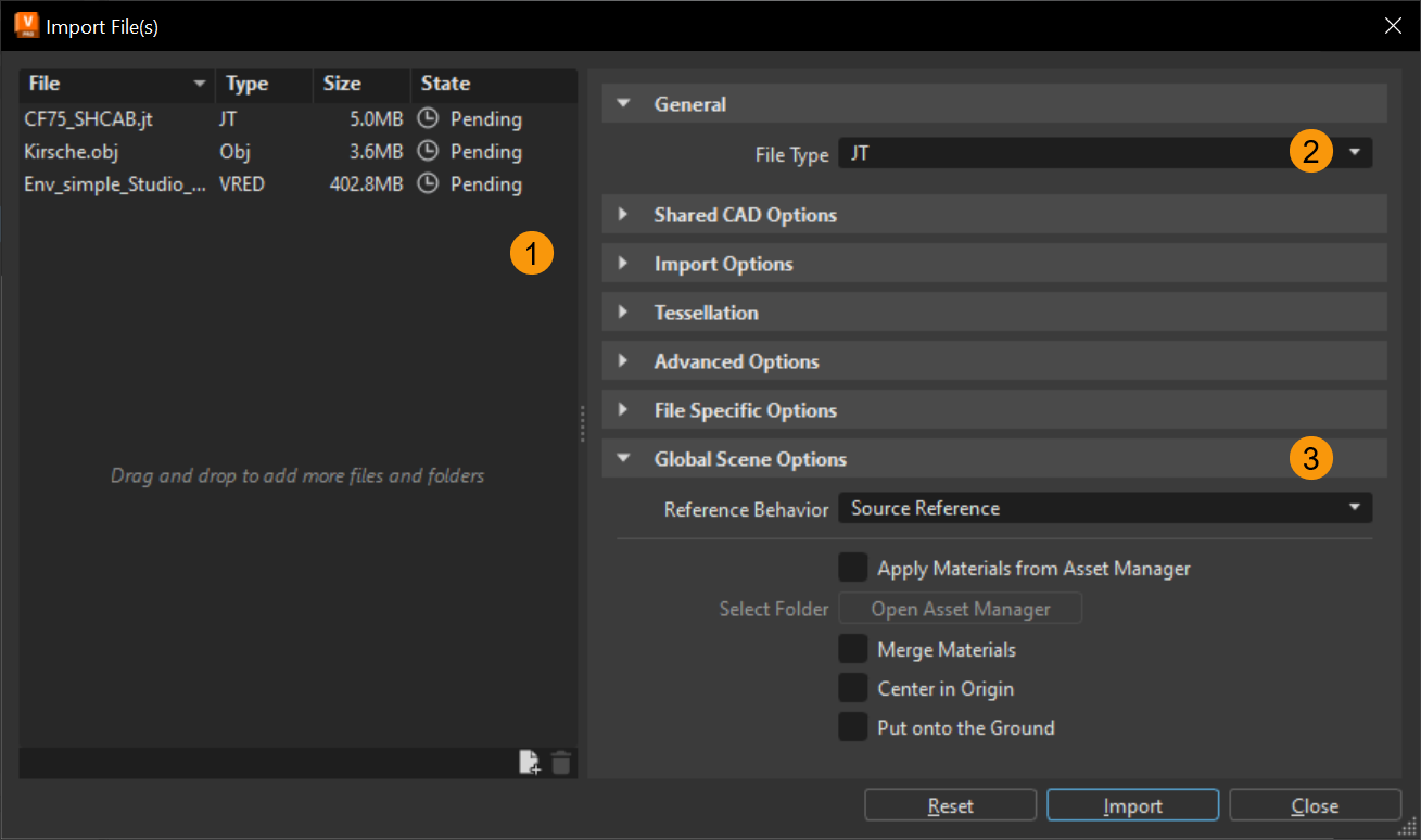

Import File(s) consists of two areas, the Import File List on the left and the File Type Parameters on the right. Drag and drop files into the Import File List or add them using the Add button. Select a file from the list, then click File Type and select the file type associated with your selection. This loads import parameters for that specific file type.
Import File(s)
1 Import File List

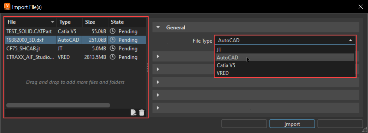

Once the Import File(s) dialog opens, the files for import appear on the left. Drag and drop more files and folders into the list. Check the State column to see if they have been added, are pending or loading, have been successful, or failed.

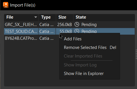

Use the right-click menu to add or remove files from the imported file list. Use other right-click options to show a file location in an explorer window or view the import logs.
Right-click menu

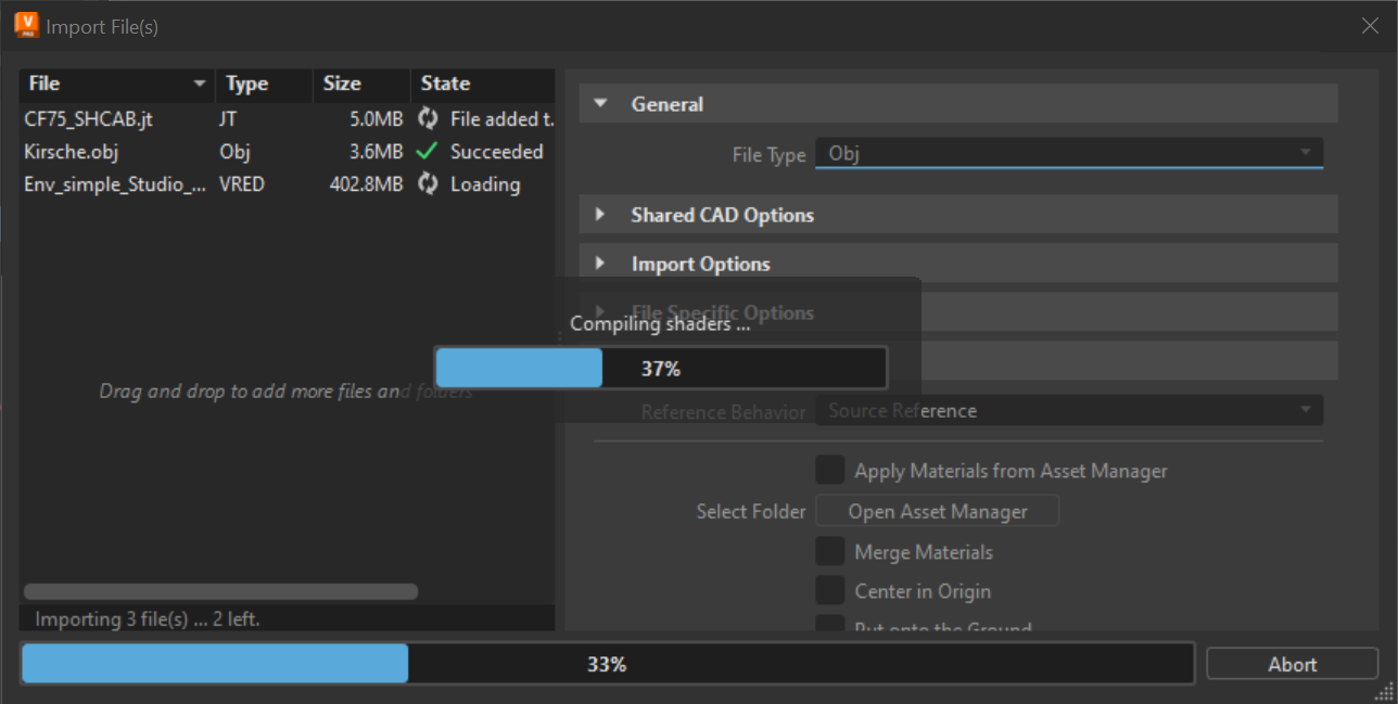

Enable and set the parameters you want. Use the Shared CAD Options > Mode option to batch convert CAD to OSB without loading files into VRED and ATF to import native Rhino .3dm files. Features like surfaces, meshes, curves, etc. are supported.
Once you click Import, you can check the state of files during import. In the State column, check the importing status. Messages like pending, importing, converted, merged, and stitched appear to indicate the current ATF (Autodesk Translation Framework) conversion state. Since logfiles tracks several ATF tasks, during import, these need more time.
Note:
If the Temporary Path preference option has been set, which changes the import temporary path of a file, the change is applied to the Import dialog the next time it is opened. However, if the Import dialog is open during the change, the path will NOT update immediately. For more information, see Temporary Path.
Keep in mind, when importing an ATF file, if the Import/Export > File Options > Options tab > Base > Temporary Path preference contains an incorrect path, the import will fail. However, when importing only non-ATF files, the path will not be validated; therefore, even if the path is invalid, the import will succeed, and no warnings will be written to the terminal.
2 Import File Parameters
General
When a file in the Import File List is selected, parameters appear to the right. Use the File Type dropdown menu to load parameters for that specific file type.
Import File List
  • File Type - Provides options for loading the correct import parameters specific to the selected file type from the list to the left.

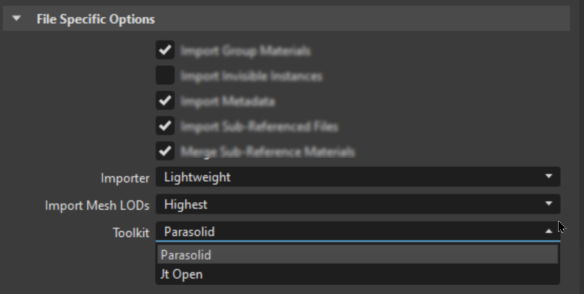

  • Importer - Choose one of the following methods for importing Catia V5 files. There should be no differences in tessellation quality, structure, material import, or naming conventions between these methods.
    • Lightweight - The faster default method for importing V5 files, which skips several operations in ATF that are not required to translate CAD data to VRED.
    • Legacy - The old method for importing V5 files, which is a fallback if issues arise using the Lightweight method.
  • Import Mesh LODs - Imports Static Mesh Levels of Detail (LOD) into VRED from 3D modeling applications, such as 3ds Max or Maya. Choose from Lowest, Highest, and All. All imports all currently selected FBX files with specified VRED settings.
  • Toolkit - When Legacy Import is activated, this option is disabled.
    Toolkit
    Sets the toolkit used by VRED. Choose one of the following options:
    • Parasolid - Uses the current behavior.
    • JT Open (Experimental) - Uses the new behavior for importing JT files.

3 File Type Parameters
Project Merge Options
Select the elements to import or merge.
  • Import Variants - Imports variant data, rather than excluding it.
  • Import Touch Sensors - Imports touch sensors, rather than excluding them.
  • Import Sequences - Imports sequences, rather than excluding them.
  • Import Clips - Imports clips, rather than excluding them.
  • Import Annotations - Imports annotations, rather than excluding them.
  • Merge Materials - Compares the materials of both scenes and eliminates duplicates.
  • Environments - When merging environments, there are four options:
    • Use From Scene - Uses the existing environments from the current scene remain. Environments from the imported file are only added if they directly reference a material in the common tab of the Material Editor. Added materials, using the default environment switch from file, use the existing scene environment default switch.
    • Use From File - Adds environments from the file and removes environments from the existing scene (unless the existing environments directly reference a material in the common tab of the Material Editor.) Otherwise, all materials use the new environments.
    • Add From File - Adds the environments switch (from the file) as a new switch to the scene and maintains the default switch. All materials keep their environment assignment.
      Note:
      This may result in duplicate environments and switches.
    • Merge - Adds the child environments of the default environment switch to the existing default environment switch. Duplicates are excluded. When merging projects, viewpoints are preserved.
  • Import Touch Sensors - Imports touch sensors, when enabled, instead of excluding them.
  • Environments - Provides environment import options. Choose from:
    • Use From Scene - Uses the default scene environment.
    • Use From File - Uses the environment from the imported file.
    • Add From File - Uses the environment from a selected file.
    • Merge - Uses the environment from the file and merges it into the default scene environment.
Global Scene Options

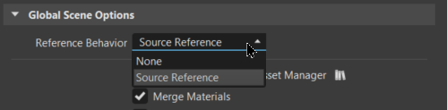

  • Reference Behavior - Determines what happens to references upon import. Choose one of the following:
    • Source Reference - Imports the references as source references.
    • None - Combines all references into the project and removes the file/reference information.
      Reference Behavior
  • Apply Materials from Asset Manager - Replaces imported materials with similar materials from the Asset Manager. Click the icon to the right to access the Asset Manager.
  • Merge Materials - Merges materials when importing a CAD file.
  • Center in Origin - Places imported geometry in the center of the VRED environment.
  • Put onto the Ground - Places imported geometry on the ground plane.
  • Import Animations - Only available for OSB and VPB files. Imports animations contained within the file.
