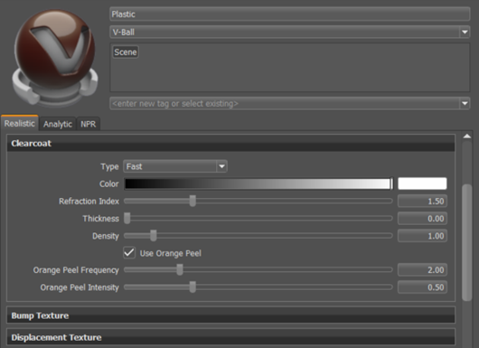

Within the new Material Editor, we added a new option for the Plastic material. Now, you can add an additional clearcoat layer. You can adjust several parameters like the thickness, color, or density of the clearcoat. With this new option, you can create, for example, a textured material with a layered clearcoat on top of it. And with the new decoupled Material Editor, you can also set a clearcoat for multiple Plastic materials at once.
