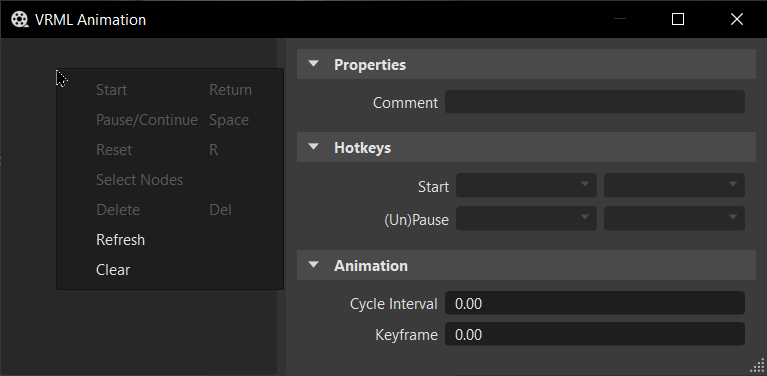

The VRML Animation module lists all animations imported in VRML file format. When these VRML animations are imported into VRED, you can play them using a mouse shortcut menu, keyboard shortcuts, or Python scripts. Animations initiated by clicking an object within the Render Window can be associated with touch sensors.
In the Menu Bar, select Animation > VRML Animation.
The VRML Animation module lists all VRML animations imported to VRED.
Right-click an animation in the list to see shortcuts for playing, pausing, and deleting the animation, and so on.
Use the VRML Animation module to change properties of VRML animations, such as shortcuts, cycle interval, and so on.
