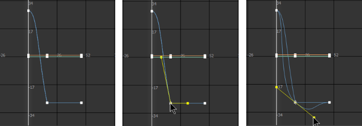

In the Curve Editor, click the node you want to change.
Drag the key to change its frame position or drag the yellow curve handles to edit the curvature (tangent) between two keys.

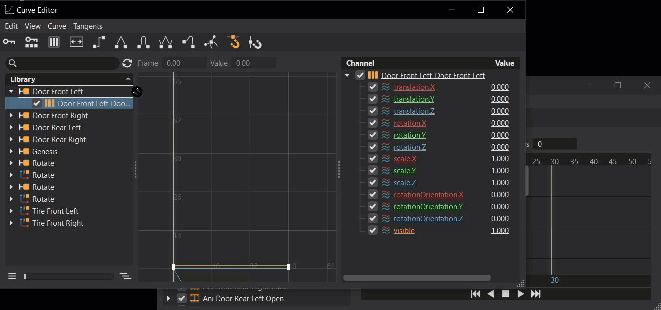

Once something has been animated, if the Curve Editor isn't open, click
(the Curves icon) in the Quick Access toolbar to open it.

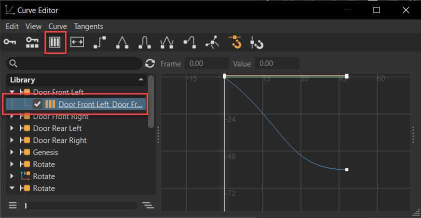

In the Curve Editor, select an element from the Library, then click
(Create an animation block element). This adds a block element to the Curve Editor Library.
