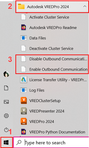

Some companies are concerned their proprietary and confidential files could accidentally be sent outside of the company. The following two batch files were added to enable and disable dark site mode and enable or disable outbound communication.
How to Enable Outbound Communication
Enable outbound communication to share views of your content with people outside of your organization.
  1. From the Windows Start Menu, scroll to the Autodesk VREDPro <version number> folder and click it.
  2. Select Enable Outbound Communication.
    Darksite Mode
How to Disable Outbound Communication
Disable outbound communication to protect your content from accidentally being sent to people outside of your organization.
  2. Select Disable Outbound Communication.
    Darksite Mode
