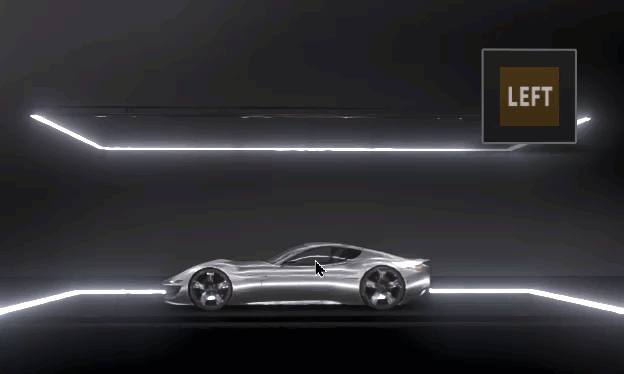

Using the View Cube
The View Cube only affects the selected object. Click the cube, its edges, or corners to switch to the corresponding position.
Click the Home button to switch back to the ICV.
Changing View Cube Behavior
Show, hide, and change the position, size, and opacity of the View Cube with the preferences found in the General Settings > Interface > View Control section of the preferences.
Select Edit > Preferences > General Settings > Interface.
In the View Control section, select any of these options:
- Show View Cube - Displays the View Cube when enabled. To hide it, disable this option.
- View Cube Position - Sets the location of the View Cube and Navigation Bar. Choose from Top Right, Top Left, Bottom Right, or Bottom Left.
- View Cube Size - Sets the size of the View Cube. Choose from Tiny, Small, Normal, the default, or Large.
- Opacity - Sets how pronounced the View Cube is when your cursor is away from it. At 1.00, the View Cube is always at full opacity, regardless of your cursor's location. At 0, the View Cube in only visible when near it. Use this during demonstrations to reduce visual clutter.
