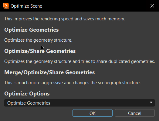

  1. In the Menu Bar, select File > Optimize Scene.
    Optimize Scene
  2. Click Optimize Options and select one of these optimization options:
    • Optimize Geometries - Optimizes the structure of the geometry.
    • Optimize/Share Geometries - Optimizes the structure of the geometry and tries to share duplicate geometries.
    • Merge/Optimize/Share Geometries - Optimizes by changing the Scenegraph structure. This has a significant impact on the geometry.
  3. Click OK.
For more advanced optimization options, in the Menu Bar, select Scene > Optimize to open the Optimize dialog.
