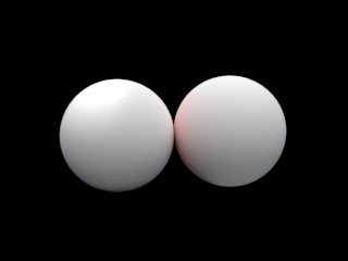

Self-intersection example
Keep the following in mind:
  • Subdividing will add more triangles, negatively impacting VR, raytracing, UV editing, and data quality.
  • Photon mapping cannot be used to do for vertex baking.
  • Cloned geometry will always share the same bake result.
  • Since architecture has many planar surfaces, vertex baking is not recommended; therefore, use texture baking.

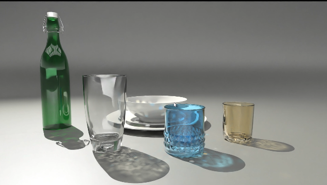

Caustics (Render Settings > Raytracing Quality > Photon Tracing > Mode) can be baked as part of indirect illumination, preferably with more than 16 indirections. The number of indirections is essentially an override of the Trace Depth (Render Settings > Raytracing Quality > Photon Tracing > Trace Depth) of the raytracer during baking.
Caustics example
Though it may take longer to calculate and requires more work upfront, the texture bake type delivers a more accurate result than vertex, without affecting the geometry. It is especially good for shadowing of anything with fine detail that is hard to display with vertex baking. Photon mapping can be used to improve difficult lighting scenarios and is also a requirement for baking Ray Lights.

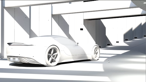

Photon mapping example
Active displacement textures are evaluated during baking. However, if Indirect Illumination has Override Material enabled, the material assignments will be replaced during baking by a flat diffuse material of a chosen color. Ensure it is disabled, if you want to bake displacements into lightmaps.
