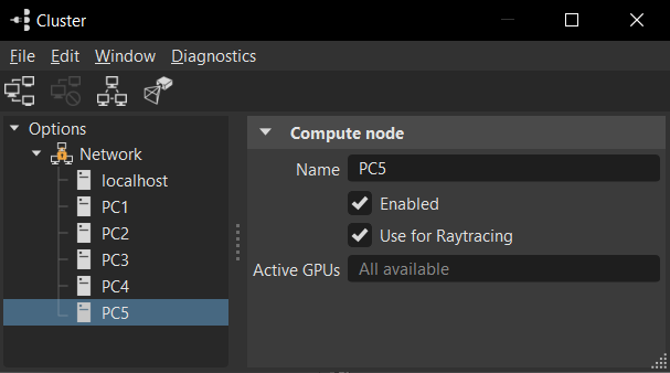

How to Configure a Cluster
Choose Rendering > Cluster to open the Cluster module.
In the left panel, select Options and choose Edit > Add network.
Do any of the following:
To add rendering nodes individually, choose Edit > Add compute node and provide the Name under Compute node in the right panel.
To add many nodes at once, choose Edit > Cluster config to open the Cluster config dialog box.
In the Configuration text box, add the configuration. A wide range of formats is recognized, including the connection string from the Cluster module in previous VRED releases.
PC1 PC2 PC3 PC4
PC1, PC2, PC3, PC4
PC1 - PC4
Master1 {PC1 PC2 PC3}
Master1 [forwards=PC1|PC2|PC3]
Master1 {C1PC01 - C1PC50} Master2 {C2PC00 - C2PC50}
You can also read the configuration from an externally generated file. For example, a startup script could generate a file that contains the names of all usable cluster nodes. If the Read configuration from file field contains a valid file name, then the configuration is read each time the Start button is clicked.
If the cluster nodes are in a local network that is not accessible from the host where VRED is running, then you must configure an intermediate node. This node must be connected to the same network as the host where VRED is running and through a second network card to the cluster network. In this setup, you have to configure two networks. The first one is the network that connects VRED with the gateway note. The second is the network that connects the cluster nodes.
Set cluster, network, and render node options in the right panel of the dialog.
To display cluster options, select Options in the left panel.
To display network options, select the Network node in the left panel.
To display render node options, select the node in the left panel.
