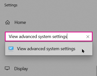

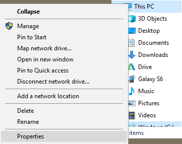

Right-click your This PC icon and select Properties.
Enter View advanced system settings in the search field and press Enter.
Click the Advanced tab, then the Environment Variables button.

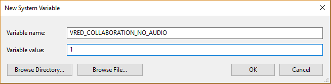

In the System variables section (at the bottom), click New. This open the New System Variable dialog.
Enter the environment variable name and a value, then click OK and OK again.

In the System variables section, click the New button to open the New System Variable window.
Enter the name of the variable (VRED2019_SCRIPT_PLUGINS), followed by the value (C).
When finished, click OK.
