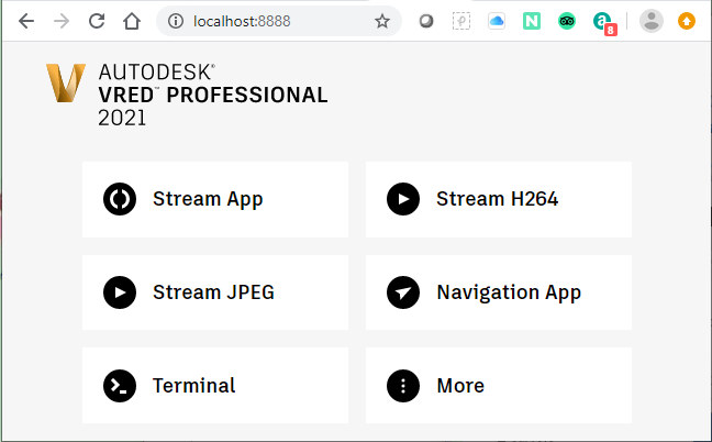

Open a web browser on your device.
Enter either localhost:8888 or YourIP:8888.
Select Stream JPEG or Stream H264.
