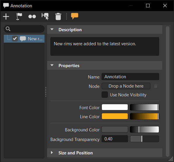

In the Annotation module, click Create .
Shift-click in your scene to select a location for the annotation.
Enter the annotation text in the Description section. Use the search field to find annotations by this name.
Under Properties, adjust the font, line, and background color, as well as background transparency.
Under Size and Position, adjust the position and size of the annotation.
