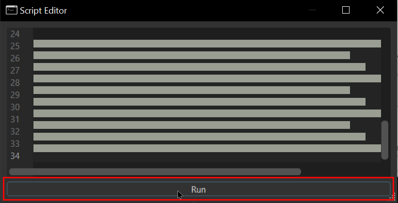

With the Script Editor, things need to be handled a bit differently. Every time you press Run, it destroys all objects created in a previous run of the Script Editor and is freed and cleaned up by Python's garbage collection.
Script Editor with Run button
It will NOT remove any objects not in the script that is loaded into the editor. You can create object instances through the command line in the Terminal that will not be touched when Run is pressed.
Here's a simple test:
class test(object):
    def __init__(self):
        print("create")
    def __del__(self):
        print("destroy")
t = test()
Running this in the Script Editor demonstrates that clicking Run cleans up before executing the script again.

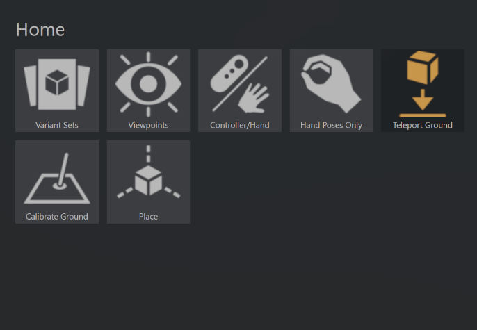

The Scripts menu contains options a list of scripted plugins, along with the xR Home Menu options.
xR Home Menu
Use the options in the xR Home Menu to customize the tools that appear in the xR Home Menu panel used in VR.
xR Home Menu
When items in this list are checked, they appear in the xR Home Menu. To remove tools from the menu, uncheck them.
