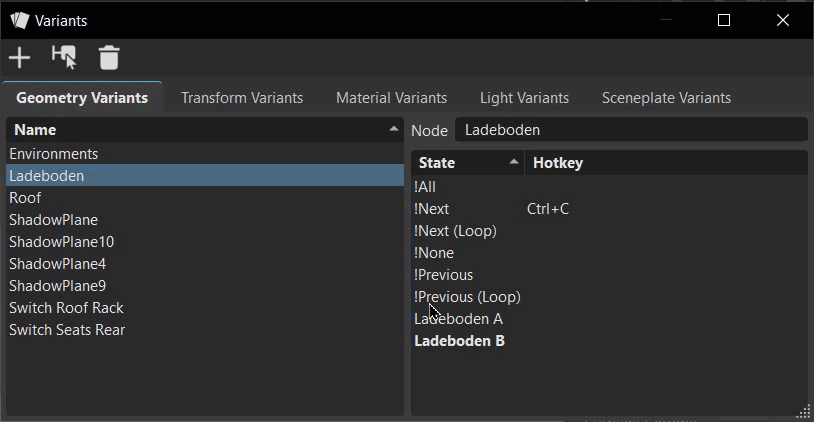

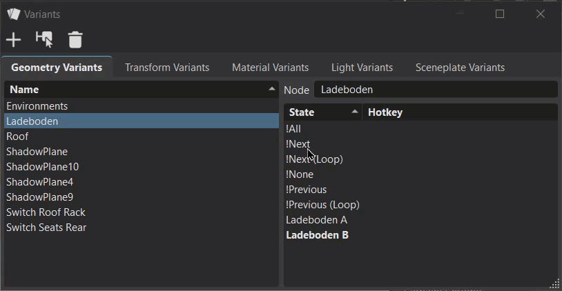

How to Set a Hotkey
  1. To set a hotkey for a variant, from the list view (left side) of the Variants module, select a node or switch node.
  2. In the section to the right, click the space to the right of the state to access its Hotkey drop-downs.
    Variants Hotkeys
  3. After entering the hotkey values, tap the blank space below it to set the hotkey.
  4. To enable a state, double-click the state. The currently enabled state is bolded; the default state is highlighted.
    States
Note:
To test your hotkey, click the Render Window, then use your hotkey.

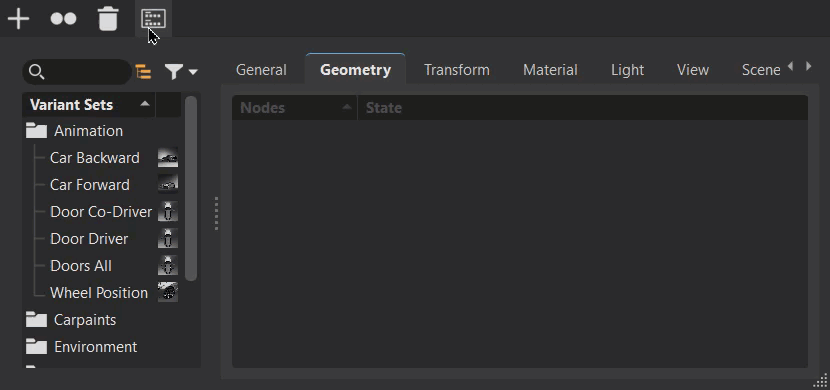

How to Create a Variant Set
Use variant sets (VSets) to define multiple states for different properties at same time. In many cases, a variant alone is not enough for managing complex models. For example, many different switch nodes are needed to represent a specific version of the loaded model. Variant Sets provides more functionality for activating many states, simultaneously. For configurators, logical connections can be generated.
  1. In the Menu Bar, click Scene > Scenegraph to open the Scenegraph.
  2. In the Menu Bar, click Scene > Variant Sets to open the Variant Sets module.
  3. In the Variant Sets module, right-click in the left side and select New Set.
  4. Click the name of the new set to rename it.
  5. In the Variant Sets module, click the tab corresponding to the type variant you want to create: Geometry, Material, or Light.
    Note:
    The other types of variants will be discussed in other sections.
  6. Drag a node or switch node from the Scenegraph under the appropriate tab of the Variant Sets module.
    The node name is added to the tab, with supported states listed in a drop-down box.
  7. To enable a state, select it from the drop-down box.
Optional: Create a hotkey for the variant set in the General tab.

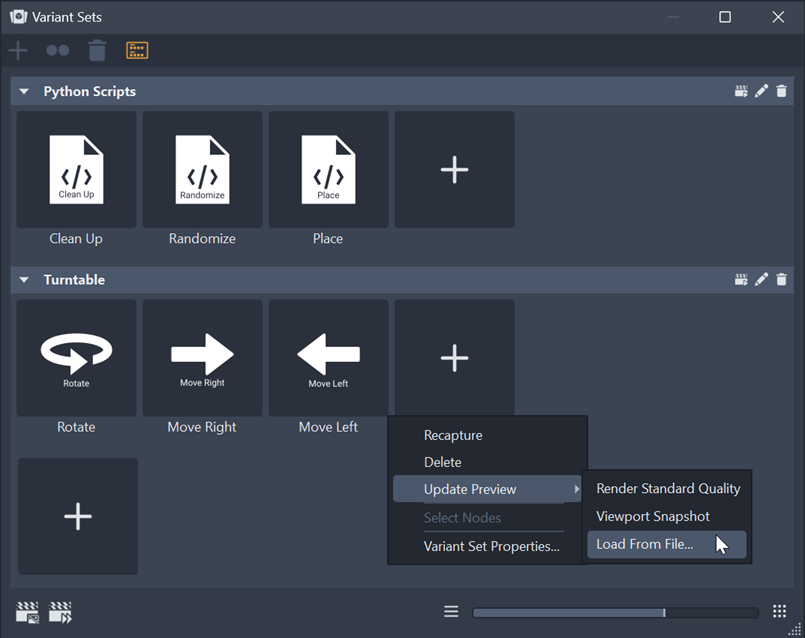

Creating a Custom Thumbnail Image
Since the preview generated from the viewport may not be representative of the action behind the variant set, use the Image From File option to the Variant Sets module for loading a custom thumbnail preview image.
Loading cutom thumbnail
  1. In the Quick Access Bar, click Variant Sets icon to open the Variant Sets module.
  2. Hover over a variant set without a thumbnail image to activate it, then right-click and select Update Preview > Image From File to locate and select a .jpg, .jpeg, or .png preview image from disc.
  3. Double-click the image to use it for the thumbnail preview.
