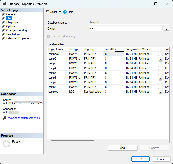

  1. Login to the SQL Management Studio.
  2. Expand Databases, expand System Databases.
  3. Right Click on tempdb and select properties.
  4. Select the Files page.
  5. If using a multi-core system, additional data files should be configured, using the guidelines below. If using a single-core system, skip to step d below.
    1. Data files should equal the number of Logical\Virtual processors available. For example, if the machine has 12 Logical Processors, there would be 1x .mdf file and 11x .ndf files. If disk space is important, "Size" of 512MB can be used instead of 1024MB.
      Note: In case of SQL 2016 or later, Data file will default to the lower value of 8 or number of logical cores as detected by setup. The value can be increased as required for a specific workload. The file names for secondary data files will follow the tempdb_mssql_#.ndf naming convention where # represents the file ordinal for each additional file.
    2. Click the Add button to add additional data files.
    3. Name the new file(s) temp2, temp3, … as needed.
    4. Set the size of each data file to 1,024 MB. If using a total of 8 datafiles, size of 512 MB can be used.
    5. Set Autogrowth to 100 MB, unrestricted growth for each data file.
    6. Set the LDF log file to combined data file total (example; if there are 2 data files total, the resulting LDF should be set to size of 2048 MB)

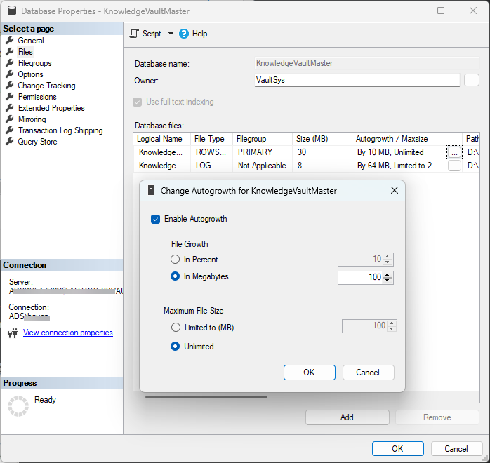

  8. Right-click on the Vault database and select properties.
  9. On the Files page set:
    • the Autogrowth value for all <Vault> databases to by 100MB, unrestricted growth
    • the Size value of all <Vault>_log files to 500MB
    • the Autogrowth value for an <Custom_Library> files to 25MB
    • the Autogrowth values for all _log files to By 10 percent, unrestricted growth

    KnowledgeVaultMaster
    By 10MB, unrestricted growth

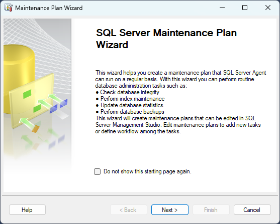

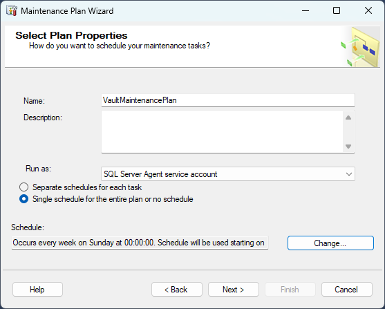

  13. Right-click on the Maintenance Plan folder and select Maintenance Plan Wizard. Click Next.
  14. In the Select Plan Properties dialog, enter Vault Maintenance Plan for the name and then click on the Change button to set the schedule.
  15. In the Job Schedule Properties dialog, set the plan to run after an Autodesk Vault Server Console backup has completed. Depending on the size of your dataset, this schedule may have to be run on a different day and time of the week. You may want to run this task on a Saturday to determine the amount of time it will take to complete and then decide the best day and time to run this job on a regular basis.

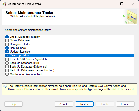

  16. In the Select Maintenance Task dialog, check the following options:

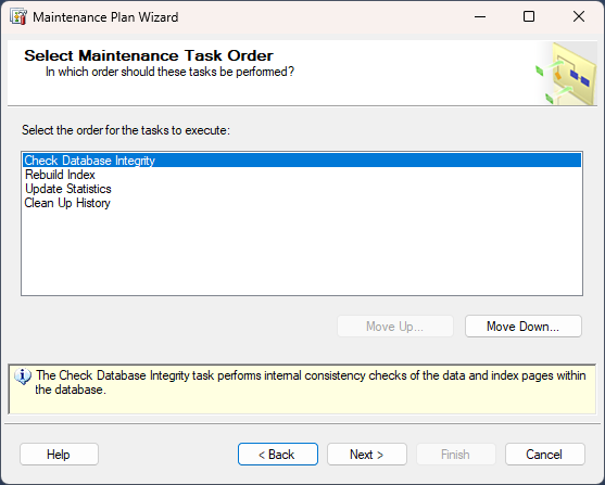

  17. In the Select Maintenance Task Order dialog, set the order to the following:

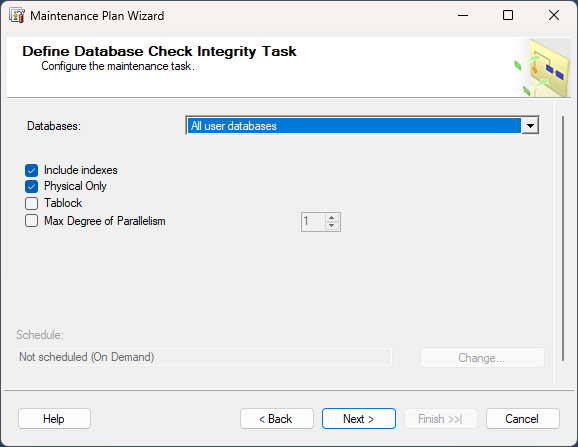

  18. In the Define Database Check Integrity Task dialog, select All user databases from the databases drop-down list and check the box next to "Include indexes" and "Physical Only".

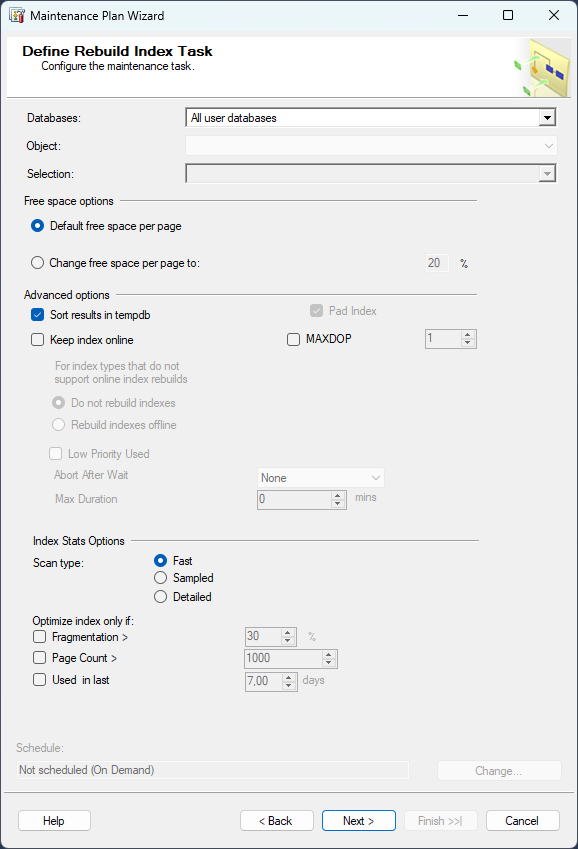

  19. In the Define Rebuild Index Task dialog, select All user databases from the Databases drop-down list.

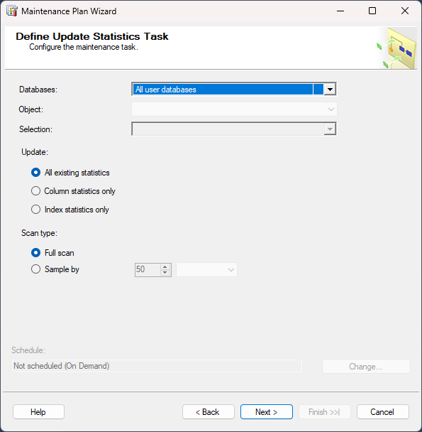

  20. In the Define Update Statistics Task dialog, select the following options:

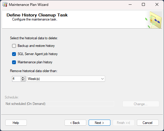

  21. In the Define Cleanup History Task dialog, select cleanup options as needed.
