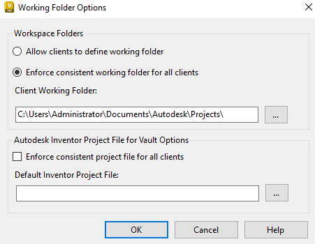

Set up a Shared Working Folder
The system administrator enforces a working folder on a shared network location for all project members to use.
Note: You must be assigned the role of Administrator to perform this action.
- Launch Autodesk Vault and then log in as an administrator.
- Select
- In the Vault Settings dialog, click the
Files tab.
- In the Working Folder section, click
Define.
- In the Working Folder Options dialog, select
Enforce consistent working folder for all clients.
- Specify the shared network location for the working folder in the
Client Working Folder field or browse to a location.
Note: The path to the shared working folder can be:
- a network path: \\designco\users\jstewart
- a path containing a system variable for a directory: \\designco\users\%username%
- Click
OK.
Close.
