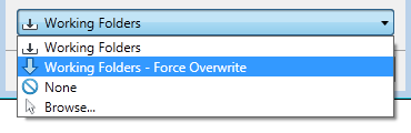

Working Folders Drop-Down Menu
Specify whether you want to use the default working folder or select another folder to store the local copies of the objects that you download. You can also select no working folder.
Note: See
Manage the Working Folder for more information.
