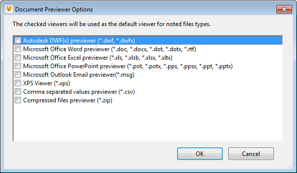

- Document Preview
- A list of applications installed on your current system are listed in the Document Previewer Options dialog. Here you can enable certain applications for previewing documents in the
			 Preview Pane.
			 By default, the Autodesk Vault preview carousel view is used.
