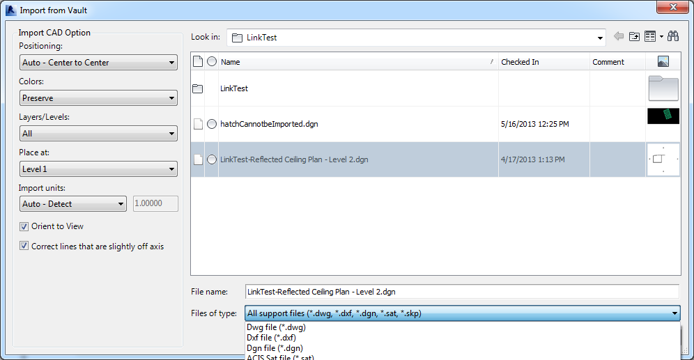

Import from Vault lets you import CAD files or images stored in a vault into the current Revit project.
However, unlike Link from Vault, when the project is saved to Vault, only the project is updated. Any uses/used-by relationship between the project and the imported file are not saved. This means if a link is modified, the file must be reimported to see the changes.
You can select a file in Vault to import into the current Revit project. You can also specify position options for the imported file on the Import from Vault dialog.
You can select a positioning preference when you import a file into the current Revit project.
The following table describes the positioning options available for selection. Refer to Import and Link Options for CAD Formats and Revit Models for more information.
