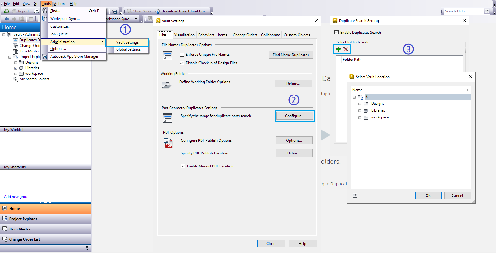

In the Vault Settings dialog box, define the search range. Specify folders where parts will be indexed.
Only Administrator and Configuration Administrator have permissions to configure Duplicate Search settings.

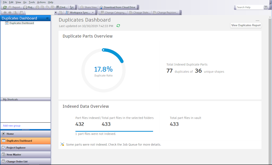

After the files are indexed, you can view the data in the Duplicates Dashboard. In Vault Client, click Duplicates Dashboard. You can view the duplicate parts report which can also be exported to Excel, PDF or Word format.

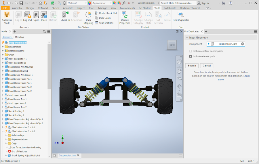

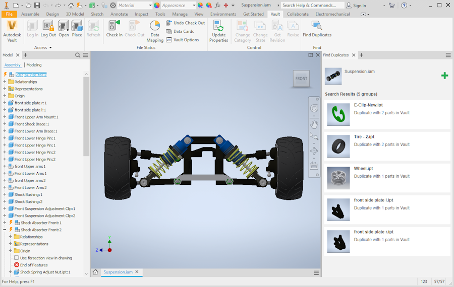

Duplicates of the parts files inside the assembly displays in the Find Duplicates panel. When you search within an assembly, duplicate groups are displayed first. Click the group to review the duplicate part files from Vault.
You can also filter the search results.
Option to replace, place, open, show details and go to Vault are available for each duplicate file.
