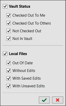

Filter the Vault Browser
You can filter the files listed in the Vault Browser by accessing the Filter menu.
You can also select Vault Status or Local Files to select all of the options in that category.
