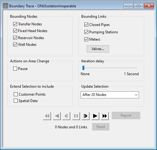

The boundary trace tool uses the Boundary Trace View.
You can set options to control how quickly the trace is displayed, and how often the screen is updated. You can also control a replay of the trace using the buttons at the bottom of the view.
Boundary Trace View
Boundary Points
There are several kinds of nodes and links that you can optionally choose as boundary points, where the trace will stop. These are:
Valves
You have a number of options when choosing Valves as bounding points. Valve options are set on the Boundary Valves dialog. Access the dialog by clicking the Valves button on the Boundary Trace View.
Boundary Trace Valve dialog

Controlling the Trace
There is a set of buttons across the bottom of the view that allows you to control the display of the boundary trace. The buttons are very similar to the simulation replay buttons on the Replay Toolbar.
Before viewing the boundary trace, there are a couple of options you can set:
The following buttons can be used to control the trace display:
Play (or Reverse Play). Use these buttons to move continuously forward (or back) through the trace. The Iteration Delay applies a time delay between nodes. The Update Selection value sets how many nodes must be added to (or removed from) the trace before the node count, link count and selection are updated.
Single Step. Add (or remove) one node from the trace. The node count, link count and selection are updated after the step
Fast Forward (or Back). The Iteration Delay is ignored. Update Selection sets the frequency for updating node and link count. The selection is only updated after the trace is finished or paused.
Pause. Manually pause the trace
Report button Lists valves that should be closed and valves that are ignored because they are inoperable or already closed.
Reset button
Removes the trace history and clears all the selections on the GeoPlan. You will have to select a new start node or link before repeating the trace.

  4. Select the appropriate boundary objects. Use the Valves button to change the options for valves if required.
  5. Decide what action you want to take if the Area Code field is different for nodes at either end of a link in the trace.
  6. Choose your trace viewing options.
  7. Use the play buttons to move forward and back through the trace.
