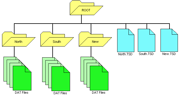

Each Time Series Data store or set of files includes:
The keys in the TSD file are used to relate information such as location, data type and units to the values in the DAT files.
Figure 1 below shows the file and folder structure. For each TSD file there is a sub-folder with the same name (without the .tsd extension). The associated DAT files are stored in this sub-folder.
Figure 1: Time Series Data File and Folder Structure

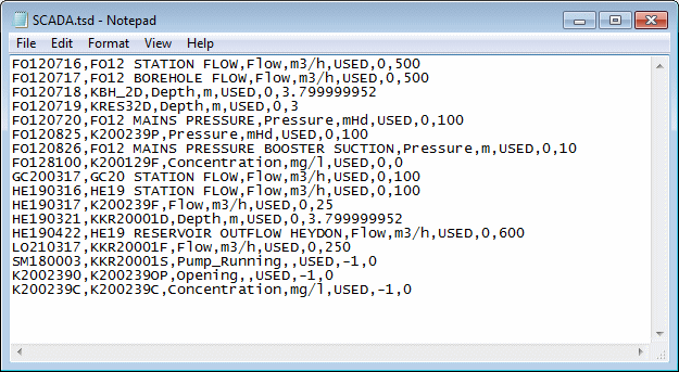

The screenshot below shows an example of TDS file opened in Notepad:
