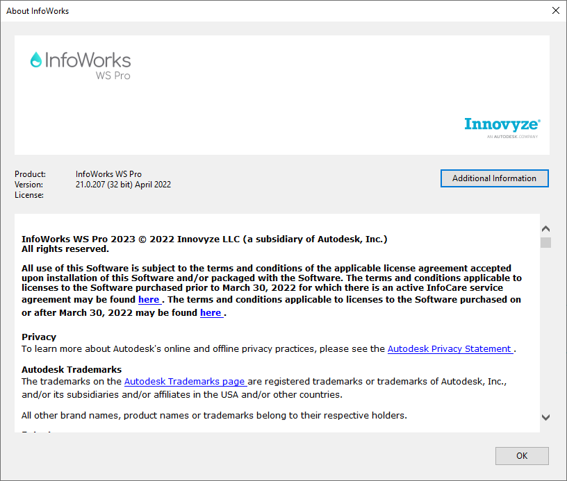

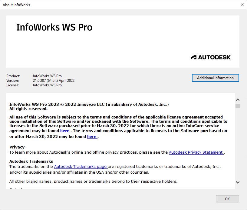

The InfoWorks WS Pro About box displays useful information about your current InfoWorks WS Pro installation, as well as Privacy and Autodesk Trademarks information.
The About box is displayed by selecting About InfoWorks WS Pro from the Help menu. The contents of the Additional Information area can be copied to the clipboard.
Show image
An example of the About InfoWorks box when using a license supplied by Innovyze:
An example of the About InfoWorks box when using a license supplied by Autodesk:
Clicking the Additional Information button displays the following information:
