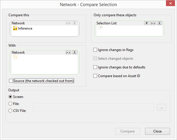

Object Type - Compare Selection dialog
The Object Type - Compare Selection dialog is used when comparing Baselines (an IWLive Pro licence is required), Control Data, Live Data or Networks.
The name of the dialog depends on the type of object the comparison is to be implemented on.
The dialog can be displayed by right clicking a baseline / control data / live data or network in the database tree, displayed in the Model Group window or the Explorer window, and selecting Compare from the context menu.
For more information, see the Comparing topic.
Network Compare Selection dialog
Network Compare dialog
Field Description
Compare this
Read only selection box, populated with the baseline / control data / live data / network from which the dialog was opened.
With
Drag and drop the object to which the baseline / live data / network / control in the Compare this section is to be compared with into the With box.
Alternatively use the Browse button to browse for the desired object.
Source checkbox
Check this box to automatically populate the With box with the parent of the object in the Compare this section.
Only compare these objects
This option is available when comparing Control Data objects, Live Data objects or Networks.
Drag and drop a Selection List into the box or use the Browse button to browse for a selection list. Only those items in the selection list will be compared.
Alternatively, click the Current button to compare all objects currently selected on the current GeoPlan Window.
Ignore changes in flags
Check this box to omit details of changes made to flags.
Select changed objects
This option is available only when comparing Networks.
This option is available when a GeoPlan Window of the network to be compared is open. Check this box to select all objects for which differences are found on the GeoPlan Window.
Ignore changes due to defaults
Check this box to omit details of changes in defaulted fields (fields that are flagged #D) from the comparison report.
Compare based on Asset ID
Check this box to compare network object data using the Asset ID of the object, or a set of objects instead of the Object ID.
See the Comparing topic for further details on rules used when comparing by Asset ID.
Output
Select the destination for the report from the Output section:
  • Screen - Differences between the compared objects are listed in a text viewer within InfoWorks WS Pro.
  • File: - Differences between the compared objects are listed in a text file, saved to a specified path.
  • CSV File: - Differences between the compared objects are listed in a CSV file, saved to a specified path.
