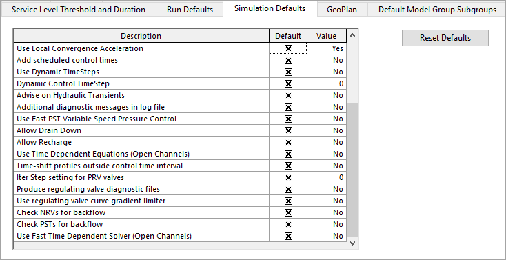

Options dialog - Simulation Defaults page
This page allows the setting of default values for simulation parameters. The default values will be set in the Schedule Hydraulic Run view when a new run is created.
The page is displayed by choosing Tools | Options and selecting the Simulation Defaults tab.
Item Description

Default (column) A cross in the box shows that the option is currently set to the default value. If you change the value away from the default, the cross will automatically be removed. Clicking the box when it is empty will reinstate the default value.
Value (column) This can be Yes, No, or a numeric value. You can change a value by clicking it in the Value column.
Reset Defaults (button) Resets all values on this page to their defaults.
