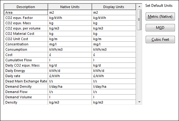

Options dialog - Units page
This page allows you to choose the units of measurement shown in InfoWorks WS Pro displays, including grids and property sheets.
The page lists the items for which data is held in the database.
Any values entered in grids or property sheets will be in the display units but will be converted to the corresponding native units for storage in the database.
The page is displayed when you choose Tools | Options and select the Units tab.
Show image
Item Description
Description (column) The items for which data is held in the database.
Native Units (column) The units used for storing the data. You cannot change these units.
Display Units (column) The units used for all display and data-entry purposes. You can change the units by clicking this column and selecting from the drop-down list.
Set Default Units
You can select a set of default display units by clicking one of the three buttons.
Metric (Native)
display using all native units
MGD
display using traditional units with flows, change in flow and volume units based on Million Gallons per Day
Cubic Feet
display using traditional units with flows, change in flow and volume units based on feet3
