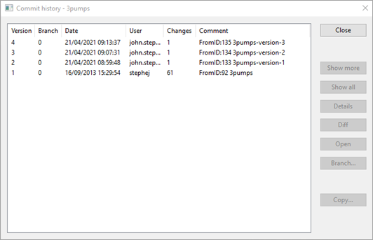

The Paste and convert to merge model option will convert an entire database or model group to use the merge version control. A copy of the model group(s) is created while the original model groups are left unchanged. All versioned objects are converted to the merge model of version control. Runs and other objects are copied and modified to use the new objects.
Note: This method only allows copying within databases. It does not allow copying between databases.
Using this option, the lock version objects are converted to merge version objects as follows:
Databases or model groups of versioned objects that are already in the merge style are copied without modification.
Runs and other objects are copied, and their references are updated. Baseline objects are copied but not converted. If runs or baselines reference items that exist in different model groups, then those items will also be copied, and they will be placed in copies of their own model groups.
