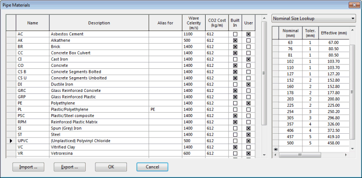

Adjusting Tolerance
You can use the Tolerance value for a particular pipe Material and Diameter to define the range of original diameters within which the effective diameter lookup procedure recognises a pipe as being a particular type.
For example, see the picture of the Pipe Materials dialog below. If the effective diameter lookup procedure finds a pipe with Material set to UPVC and Diameter between 402mm and 410mm then it will recognise it as a pipe of a specific type. The procedure will replace the Diameter value with the effective diameter, from the lookup table, of 372.5mm.
