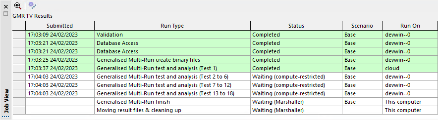

The status of a queued job is set to Waiting (compute restricted) in the Job View window. For example:
When a job is uploaded, it is processed when an instance becomes available. When complete, the next job is uploaded and then processed when an instance becomes available, and so on until all the jobs in the local agent queue are complete.
